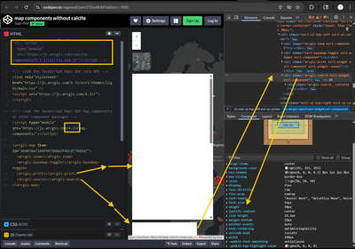

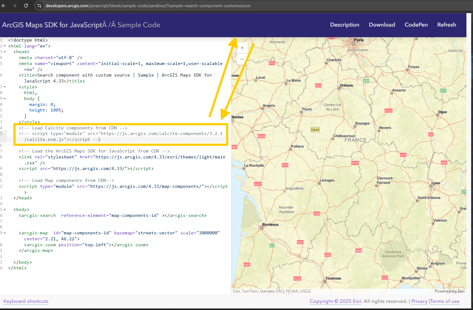

v4.33,  bug...search component will disappear ( height = 0px ) if you don't use calcite component.
while V4.32,   search component don't tie to calcite component.
all other component works fine, except Search component tie to calcite in v4.33.
https://developers.arcgis.com/javascript/latest/sample-code/sandbox/?sample=search-component-customs...

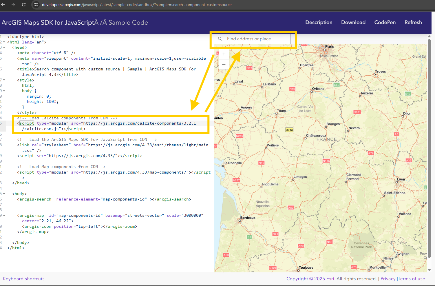

here is sample if you have v4.33 with calcite, search is fine
If you comment out calcite, search box is gone, ( height: 0px )

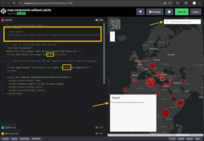

Calcite is a dependency for the map components. We have built the map components using Calcite so you will need to include it as a dependency for things to work correctly. It was working previously because Search wasn't fully refactored from a widget to a web component.
https://developers.arcgis.com/javascript/latest/get-started/#setup

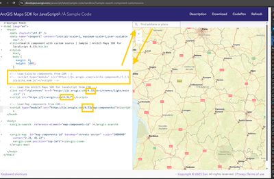

hoogw
here is v4.32,  comment out calcite,  search box is fine.
I want esri do fix the same for v4.33

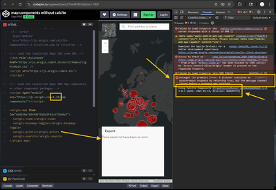

I could look into it further, but `@arcgis/core` also imports specific calcite components.  Not the whole library, but only the specific calcite components that are used by the widgets.  Some of the web components may continue to work without adding calcite directly as a dependency because those same calcite components are included with core. This isn't very reliable though and moving forward fewer calcite imports will be happening in the core api as widgets are deprecated and refactored to be components.  Print is an example of another component that will fail to work without importing calcite as a dependency.
https://codepen.io/sagewall/pen/ZYGwWJM
