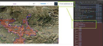

hoogw
2025, v4.31.  this solution no longer works. 
The error I had is can't find this element.
