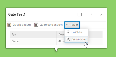

n1kl4s
Hey, sure! This is what the popup looks like when there is “enough space”, i.e. the screen width is above the calcite breakpoint (the goal is that it always looks like this):

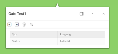

This is what it looks like when the screen is “too narrow”:
In my eyes there is enough space, the chrome element inspection also shows that the popups are both 450px wide (as expected, you will see next).
