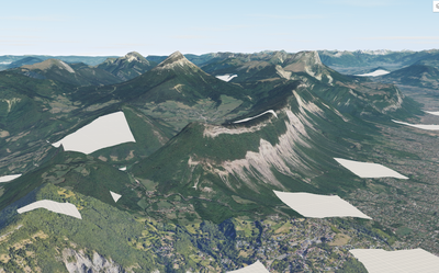

It looks like this is now possible with JS API 4.29:
const layer = new IntegratedMesh3DTilesLayer({
  url: "https://tile.googleapis.com/v1/3dtiles/root.json",
  title: "Google tiles",
  customParameters: {
    // see https://developers.google.com/maps/documentation/tile/3d-tiles-overview
    "key": "YOUR API KEY"
However it looks like some tiles failed to load:

The JavaScript Maps SDK supports loading integrated mesh 3D Tiles data as of version 4.29. We do not yet have official support for Google's Photorealistic 3D Tiles but we are working on it.
@VictorBerchet Would you mind letting me know the location where you encountered this issue?
