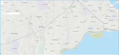

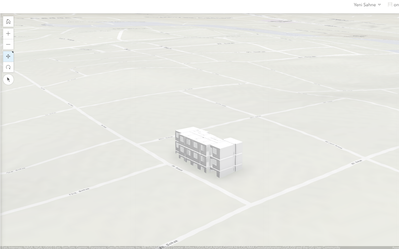

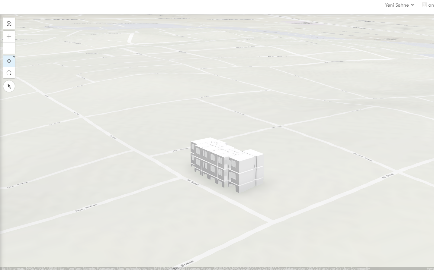

as you can see in the picture ( Feature Layer , Geometry Type: esriGeometryMultiPatch) is added as a scene layer.

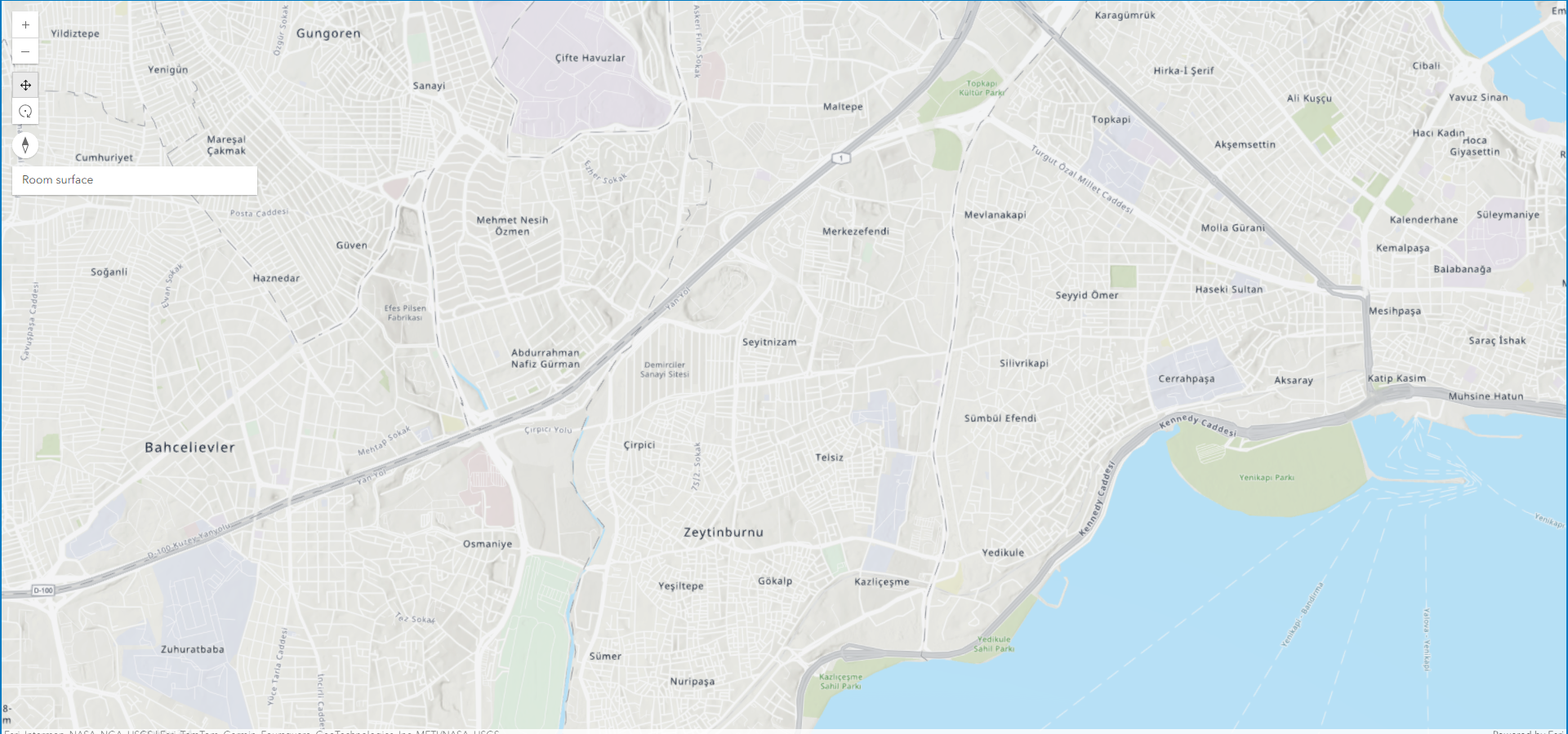

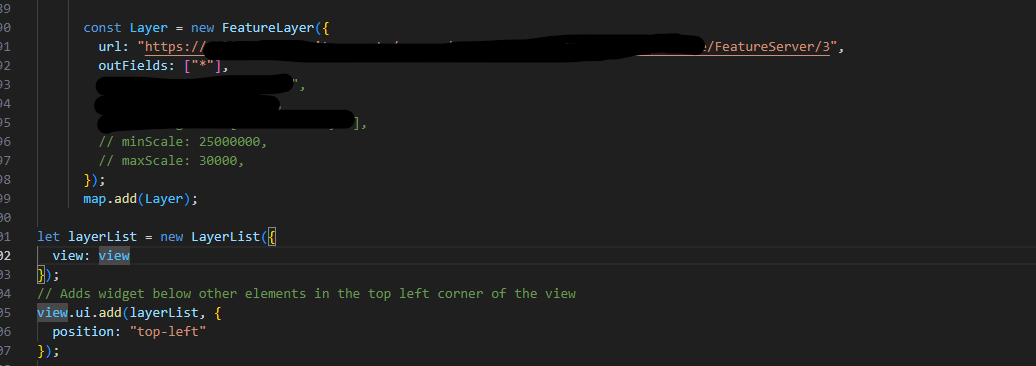

As seen in this image, when it is wanted to be added as a FeatureLayer, it is not added to the map. It is shown in the layers but the map is not visible.

Feature layers with geometry type multi patch are not supported by Scene View, you need to add them as scene layers. I'm afraid we don't have that documented anywhere, but you should see a console warning in your app indicating this.
