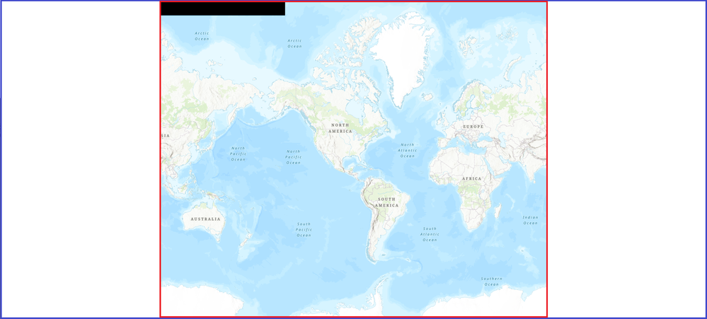

This appears to be a bug.  Below is a screenshot from our viewer with a red border added around the map image, and a blue border around the map's element on the page:
The documentation for MapView.extent says this (my emphasis added): "The extent represents the visible portion of a map within the view as an instance of Extent."  Based on this, my understanding is that the extent property in this instance should return the coordinates of the red rectangle, but it actually returns the coordinates of the blue rectangle.
