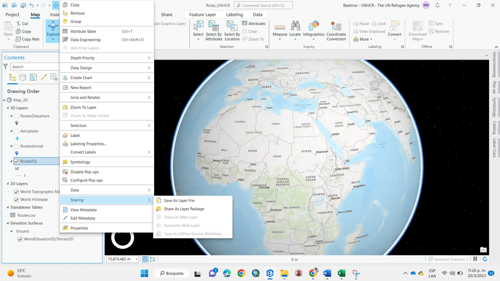

I have a layer of lines that I have to visualize in my application created with the ArcGIS api for JavaScript but when I load it, it is not visualized. I tried to publish it from arcgis pro as a scene Layer but it did not allow me. Do you have any recommendation to apply to solve this problem?
I attach a view of the layer from arcgis pro and I will leave a link to the layer.
