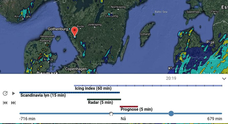

Our application utilizes multiple meteorological layers from multiple WMS-servers. The layers have different TimeDimensions (both start/end and intervals) and user is able to mix and match these as he deems fit. The user is also thereafter able to replay the data via a TimeSlider, and view the Time dimensions for the different layers.
The above is what we are trying to replicate in ArcGIS. It shows the data from 4 layers from three different servers. The layers all have different start/end times (visualized by the colored bars) and different intervals (the number inside the parentheses and the vertical lines across the colored bars)

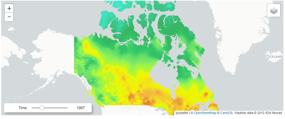

I cannot use Javascript to load this to a simple web app. However, I am able to get this from ipyleaflet easily:IpyLeafLet.PNG

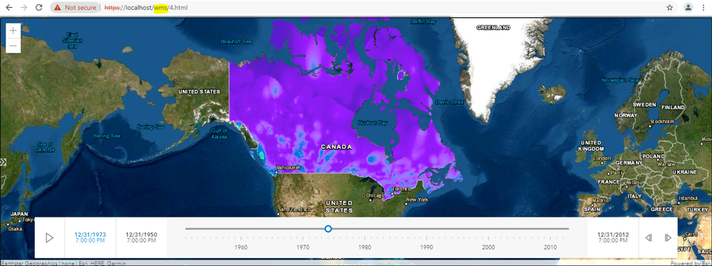

Finally, I got this work, using ArcGIS JavaScript API 4.21. Just to share the experience, here is the picture:WMSlayer.PNG

The tricks are the following:
1. Add proxy: copy the contents inside the DotNet folder to your web server, say, C:\inetpub\wwwroot\proxy. This is required as the WMS layer server does not support CORS.

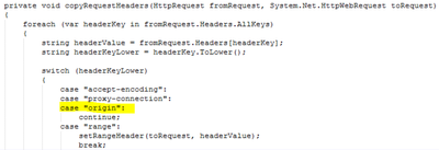

2. Make changes to the proxy.ashx file: In the copyRequestHeaders method, add case "origin": proxy.PNG
 I.e., make sure "the proxy does not send the Origin". This is the key. Thanks to @AnneFitz for it.
