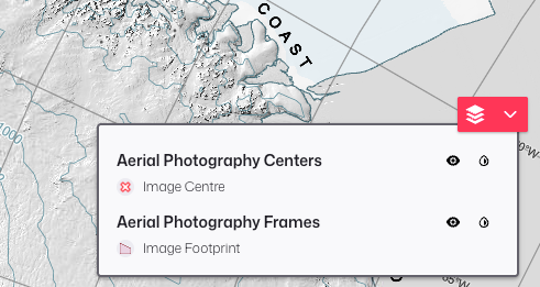

Currently it is difficult to generate a custom implementation of a legend for a map layer without relying directly on the Legend map component/widget. To build a bespoke legend UI, an application developer typically has to:
  • Add significant custom logic to process a renderer into HTML for display, or
  • For OGC services, make additional calls to external services to obtain legend information.
At the same time, there is clearly existing logic in the Legend view model for producing HTML (or DOM structure) for different layer types, but this logic is not programmatically exposed for reuse.
Proposed solution
Introduce a set of reusable utilities (similar in spirit to existing symbolUtils) to generate legend content for a given layer. For example a function that, given a Layer (or renderer), returns a structured or HTML representation of its legend items.
The utility would be similar to the renderPreviewHTML function.

Hi @JonathanDawe_BAS , Thanks for submitting this idea.  I'm hoping to get a little more information about the HTML structure desired.  Recently with the 5.0 release we have documented a lot more of the legend view model.  Could you possible take a look at the view models activeLayerInfos and the newly documented ActiveLayerInfo legendElements  they might provide the functionality you are looking for.
https://developers.arcgis.com/javascript/latest/references/core/widgets/types/#LegendElement
If not, this sounds like a good idea if you offer a bit more detail on what you would like to see implemented and what's currently missing.

@Sage_Wall - I had completely missed this subtle addition! The new Legend Elements is most likely exactly what I was looking for - I composed this idea based on feedback pre 5.0
I'll go away and do some testing and see whether this meets the requirements we have!

@Sage_Wall - After some testing this works perfectly and provides exactly the api I was hoping for! A huge thanks to the whole Esri Development team!
