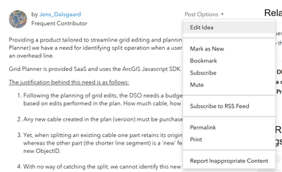

Jens_Dalsgaard
I don't see the option for moving the idea as suggested - please elaborate:
