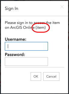

If you created the layer using the url property, the modal login dialog will look like this:
Not very useful.
