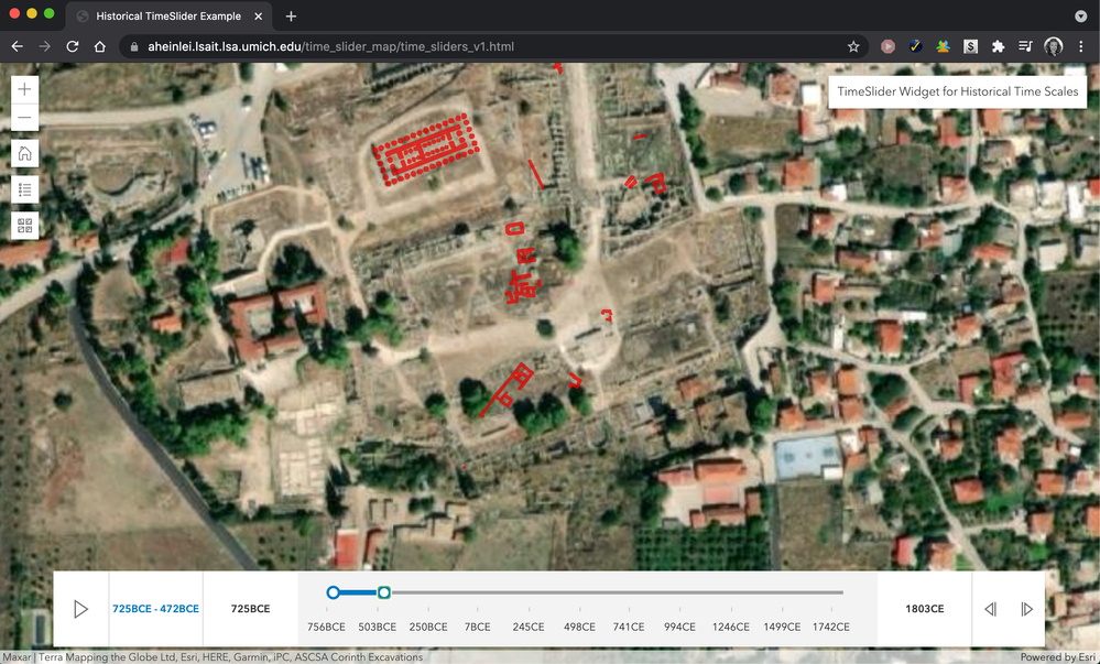

Filtering to the earliest structuresFiltering to the earliest structures
 Filtering to the earliest structures, around 800-500 BCE

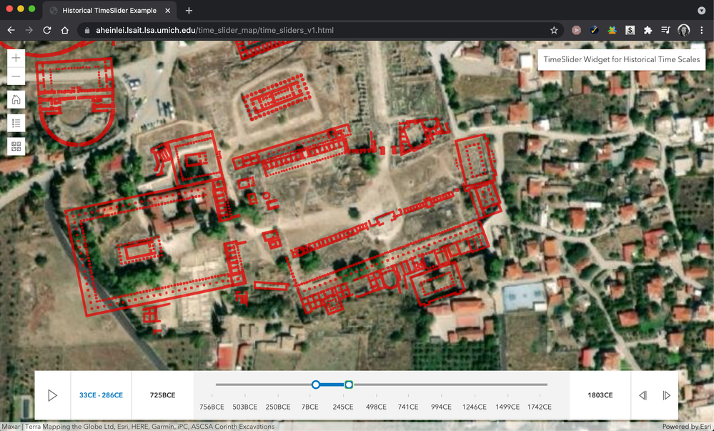

Scrolling to a later date shows more structuresScrolling to a later date shows more structures
 Scrolling to a later date shows additional structures
