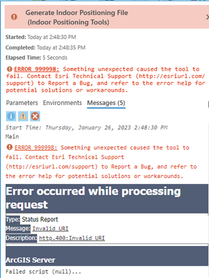

Hi everyone
I´m Simon from Colombia.
I have been deploying the IPS Solution, for the Esri Colombia office, in ArcGIS Enterprise, version 10.9.1. I made the change in the service definition, for uploading pb files.
All data is referenced in the geodatabase enterprise whit branch versioning.
When I try to generate the indoor Positioning file, I get the error # 999998 😞
I'm executing this tool in ArcGIS 3.0.3
Could you help me to know what I must do to generate the indoor positioning file?
Thanks for your help

Hi Simon,
I have an idea that could resolve your issue.
Select the IPS Recordings for the Generate Indoor Positioning File GP tool by clicking on the browse icon next to the IPS Recordings parameter, navigating through your portal items, and manually selecting the IPS Recordings from the web feature layer, as shown in the screenshot below.
Manually selecting the IPS Recordings web feature layer.Manually selecting the IPS Recordings web feature layer.
Do the same for the IPS Positioning table.
We have noticed that, sometimes, the selection either from the drop-down menu, or dragging the IPS Recordings layer from the active map view, creates similar problems to what you reported, because the web feature layer URL is not copied properly.
I hope this works. If it doesn't, please let me know and I'll try to find another solution for you.
Cheers,
Pantelis

SimonMarin
Thank you @pkaniouras
now it works.
it's very rare. Because when I get errors, the table and layers in a map in arcgis pro were referenced from a service layer.
