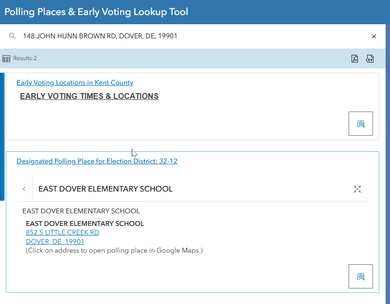

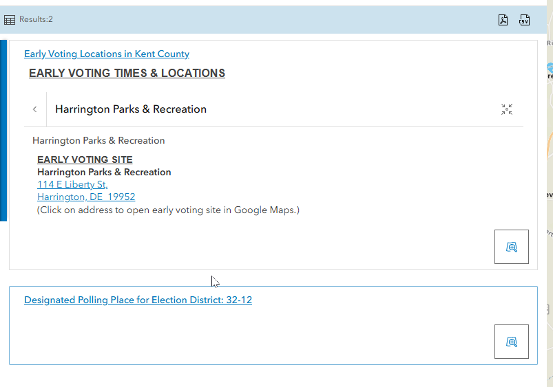

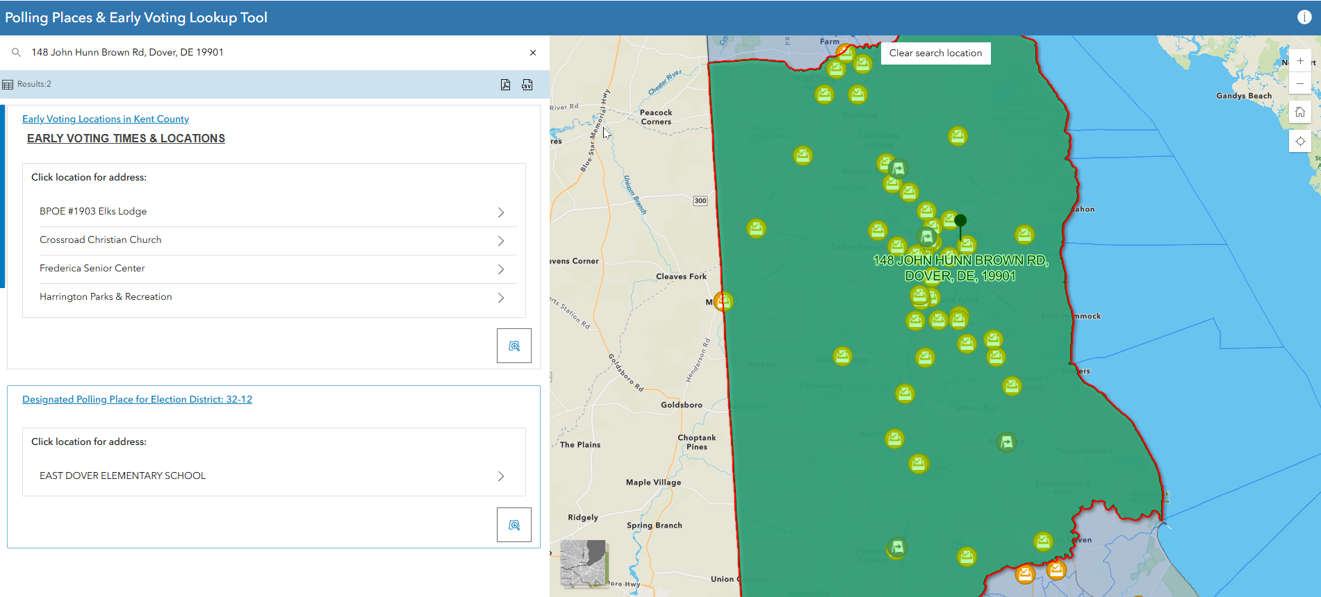

I have developed a Zone Lookup Instant App for our Department of Elections, to show designated polling places and early voting sites.  The app has worked quite well, though in the process of updating the data, I noticed a peculiar issue with the returned results.
The data and the app are both hosted in AGOL.  There are 2 sets of related layers, both of which are a polygon layer and the related points.  When selecting an address within the tool, it correctly returns the multiple early voting sites and the designated polling places, which are related records.  If either individual result is selected from either set of results, the opposite set of results disappear.
Here is the public Instant App:  https://gis.elections.delaware.gov/apps/5bc1fa9352464944be601441655e36a0/explore
Test address:  148 John Hunn Brown Rd, Dover, DE 19901 (local Target store)
Search results correctly show 1 polling place and 4 early voting sites.
If I select one of the early voting locations, the polling place results disappear.
The app needs to be refreshed in order to research the address.  Once I get the results again, I select the single polling place, and the early voting results disappear. And once again, the app needs to be refreshed to see the other results.

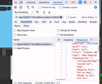

Can you share the configured info for the app - that might help us be able to setup a reproducible test case. You can get the JSON to share using dev tools like the Chrome developer tools. Here is info on how you open the dev tools. https://developer.chrome.com/docs/devtools/open
Once open you can look for the network tab then paste your appid in the filter section and click the Fetch/XHR option to only see those requests. If you click on the request with your appid you can copy the response and either send it to me via direct message or paste it here.
