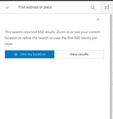

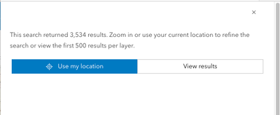

KellyHutchins
Esri Notable Contributor
 Currently this is only available in Nearby. But after the next release of ArcGIS Online this will be available in Zone Lookup too. Here's the result you'd see where it displays the total result count then lets you either zoom in or view the first 500 results for each layer.  Let me know if this won't work for your use case?
