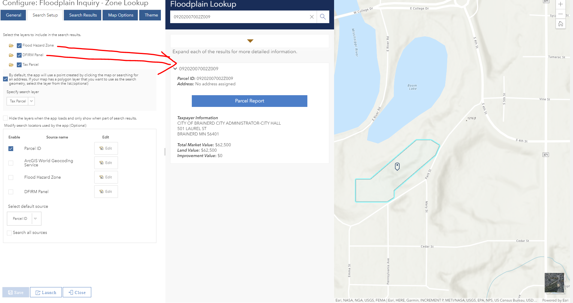

Hi all,
The ArcGIS Online June 2019 update happened last week and I've gotten to work with the Zone Lookup Configurable App template. Very cool!
I've enabled the setting to use a polygon as the search geometry, where features from another layer that intersect the selected polygon have their results returned, but it appears that only that layers features are returned (not returning the other layers info).
Has anyone else experienced this yet? Perhaps I'm misunderstanding the configuration options.

As for your question, your understanding that the specified search layer should include features that intersect with the polygon is correct.
Have you tried clearing your browser cache? Since we are seeing one result appearing from the search it might be that something was cached.

KyleWikstrom
Hi Sarah!
My sorries for neglecting this! I've checked this now, and it seems that loading time may have simply been slow.
