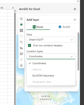

kaww02
I do think that excel seems the easiest for what we need. However, the address choice for mapping the points is greyed out.  I'll have to dig into why but otherwise that may be simple enough for her. Thank you,
kaww02
Figured out why Addresses was greyed out for anyone who sees this later - it was as simple as I wasn't logged into my ArcGIS account.
