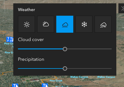

Yes if you select the weather option buttons you'll see sliders appear that allow you to define things like cloud cover, precipitation, fog etc.
Screen Shot 2022-10-17 at 9.23.24 AM.pngScreen Shot 2022-10-17 at 9.23.24 AM.png
