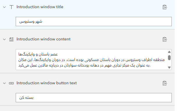

Faiez
Hi Sarah!
Sure, here it is.
Best,
Faiez
SarahMcDonald_Esri
Hi @Faiez
Thank you for sharing that screenshot. Is the text showing up correcting in the launched app? Here is a sample app that is set up to use english and arabic locales: https://webapps.maps.arcgis.com/apps/instant/sidebar/index.html?appid=e6d511244c1741bc82ff25dbb56ce0...
In the screenshot you shared, the configuration is being viewed using an english locale. So the formatting should match that. If you view the language switcher/app configuration using an arabic locale, the format should match that.
Please let me know if there are additional questions.
Thanks!
Sarah
Faiez
Dear Sarah!
Thank you for your time and kind support. The screenshot I sent contains Persian text and clearly shows that RTL rendering is not working correctly. Based on my testing and review, ArcGIS Instant Apps does not fully support Persian (Farsi) in the same way it supports Arabic. The following points outline my observations for your kind consideration:
