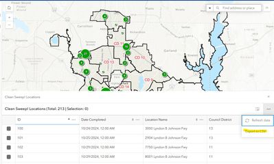

My table view is enabled and the table shows in my Sidebar Instant App, but when I try to Export to CSV the table does not download.

Having this same problem, I believe Export to CSV is broken in Sidebar.

Are either of the apps public? I just tested with a sidebar app in Chrome and was able to successfully export to csv
