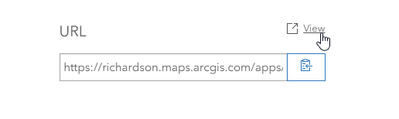

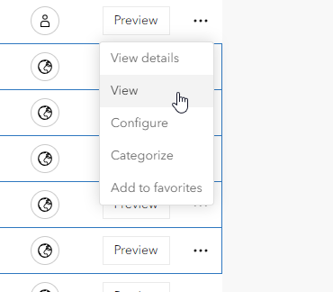

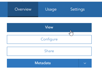

Hello. We have a bug and need help. There is some very strange behavior when we have developed a few Instant Apps within our organization. After being logged into my organization, in my content when I review my apps item details and I press "View" it opens the following link without an item number to https://richardson.maps.arcgis.com/apps/instant/basic/index.html
 which is Washington State Traffic Volume  app. I'm in Texas. It's not even honoring our organizations extent. I have to go to "Configure", "Publish", then "Launch" for it to open the app we developed. This is what we want. https://richardson.maps.arcgis.com/apps/instant/basic/index.html?appid=4598ad2cca47493d9aa7f5cacf8c2...
We have several Instant Apps basic viewer that behave like this.
Below are all the ways I "view" and the Instant App opens the Washing State app. This also happens to other members of our organization.

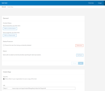

Hi Sharif,
What probably happened is that the URL to which it needs to look at is invalid. To correct that copy the URL which you see under the metadat button (last screenshot), go to the settings of the instant app and paste the url in the URL box under Instant app:
best regards,
Jelle Stuurman
ShariF
Thank you for that advice. I tried it and it does make the actual app open as it should! I guess I would like to know why it's not working as it should. I appreciate your time.
