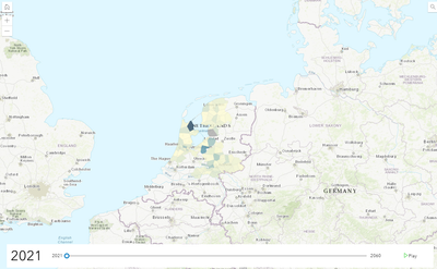

I tried the new Slider  Instant App today and would like to share my first impressions.
  • I really like how you can select an integer field for the slider. That way, you don't need a date field in the featureservice and a simple 4 digit year as integer is enough. It also gives a very simple and clear UI.
    The time slider on a time enabled field has a lot of options and these options are sometimes not necessary. The example in the screenshot above shows a simple slider without unncessary options. Just select a year and that's it. I really like this UI/UX

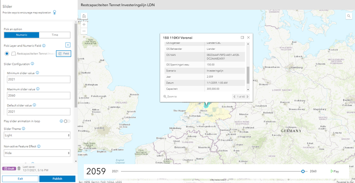

  • Popups don't work like I expected. I expected to see only the selected year in the popup, but instead I get all 40 features for all years:
    Would it be possible to add this option to the configuration? To show only the features in the popup which are visible for the selected slider position? That way, my popup would show only one feature.

Hopefully, some screenshots are enough:
Here is how my configuration for the time slider looks like. I selected Numeric and the 'Jaar' field and kept all other options at default.

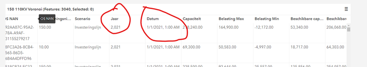

About my dataset:
I have two fields in the dataset, the first 'Jaar' (year in Dutch) is integer data type and only contains the year. The data in my datasets is order by the year field, not on purpose, but maybe that's why it works here. I also have a 'Datum' field (date in Dutch), but I only use this field in the popup.  The layer is time enabled on this field, because the layer could be used in other applications where the Webapp Builder time slider could be used.
I think I created the layer as an empty polygon layer in ArcGIS Online and used a Notebook script to do some data preparation and from the Notebook Script, I add the features to the layer.
