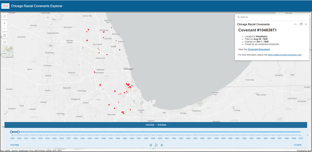

For example, look at polygon located on the corner of East 64th Street and South Evans Avenue in the heart of Chicago (show below).

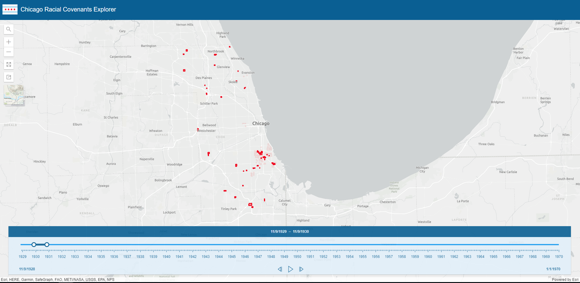

This polygon is active from Aug 25, 1929 to Jan 1, 1949. In the image above, the pop up is viewable since it's start date, Aug 25th, 1929, is within the current time interval from Nov 9, 1928 - Nov 9, 1929. However, when I change the current interval to a year after, Nov 9, 1929 through Nov 9, 1930, the pop up does not appear upon click even though this polygon is still active. This problem is shown below.
The app recognizes that this polygon is active since it is not colored light pink, but the app does not pull up the pop up information upon click.
The pop up is important because it provides our users with attribute information about the racial covenant the polygon is representing. Without the pop up, the user is provided with no information even though this polygon is active during the current time interval.

@KatherineHumphreys  this is a bug with the slider app and I've logged an issue.  A workaround, until this is resolved, is to remove the non-active feature layer effects. This will keep the pop-ups working while the slider moves.
