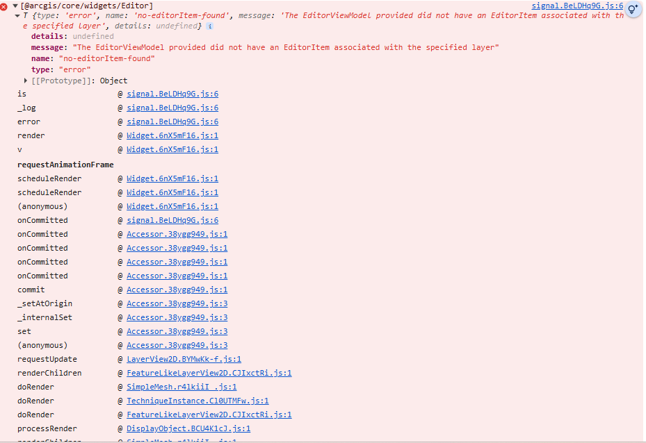

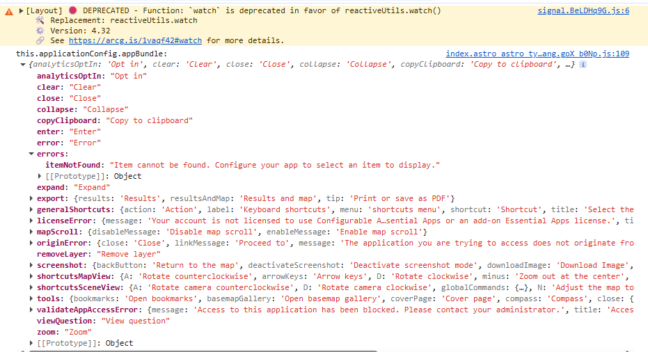

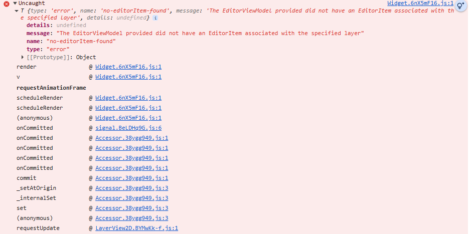

KeeganClifford
Thanks, Kelly. Attached are the errors. I'm seeing. Screenshot 2026-04-23 142108.pngScreenshot 2026-04-23 142033.pngScreenshot 2026-04-23 141959.png

Do you have editing enabled? If so can you disable it and see if the app loads? Also is this Enterprise or Online?
KeeganClifford
Yes, editing is enable. It's now disabled and there are no errors - Online.

KellyHutchins
Esri Notable Contributor
No this isn't a common issue. Based on the error message it seems like the app has an issue with the editable layer. Can you submit a support issue for this one so they can help take a look at that layer?
