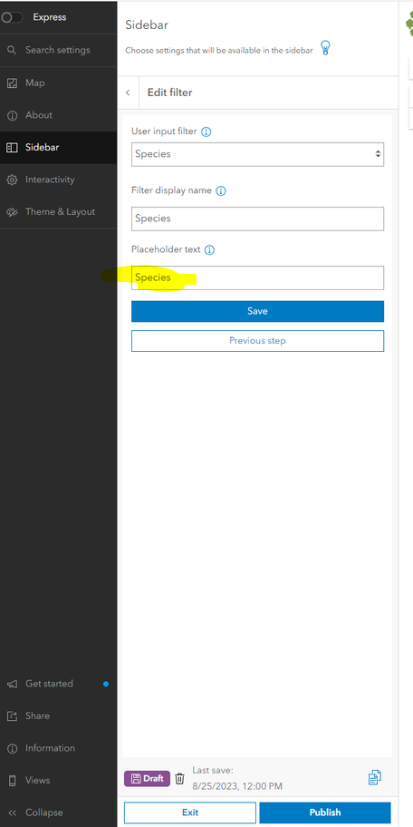

When I try to delete the placeholder text of a field in a filter, it will not save.  I can remove the placeholder text, click save and publish and it will not take.  Ideas on this or is there a specific order you have to click save or something?

Thanks for bringing this up. I was able to reproduce the behavior on my end and will pass it along to the team to look at. One thing I did notice is that I am able to replace the existing placeholder text okay, but just deleting it entirely doesn't work. If you are looking for no text to appear there, you could try to replace the existing text with a space. I found that when I did that no text appears in the placeholder text for the user input filter.
