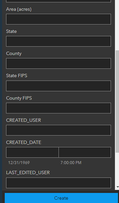

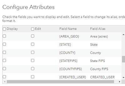

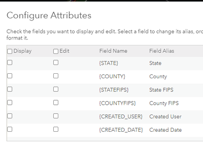

I have a Sidebar instant app that I have the edit widget turned on - however, I have no idea where I need to edit the feature layer because there are fields showing up in the edit widget that shouldn't be. These fields are turned off / not editable in the feature layer visualization, the web map in map viewer classic, the web map in the new map viewer (not showing up in the pop-ups tab) yet in the side bar edit widget they are still showing up - Can someone please point me in the right direction as to where these fields need to be changed?
Feature layer visualization:
webmap classic:
