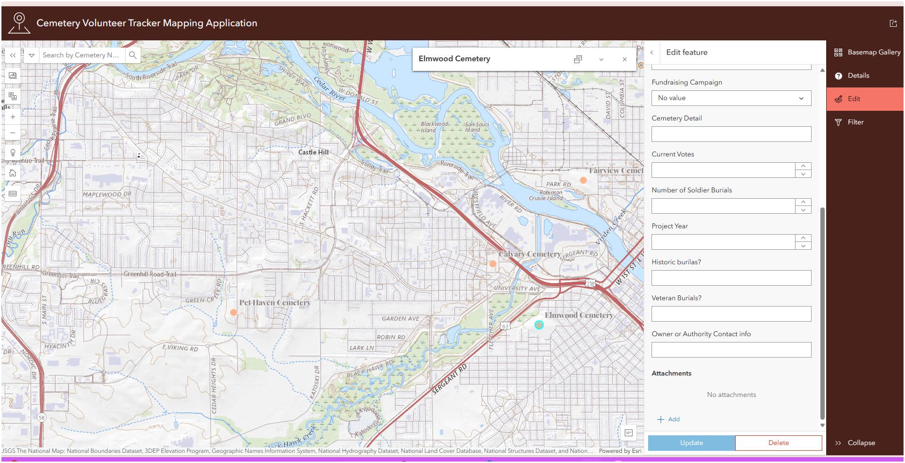

Hello,
I am configuring the Sidebar Instant App so that I can display and edit related records. I haven't been successful thus far. I thought that if I had the 'classic pop up' option turned off, it would show and let me edit the related tables, but I can't seem to get it to work.
Is this not a feature with this Sidebar app?
If not, is there an alternative application configuration someone can point me to?
Many thanks!

In order to edit related records it looks like you need to configure the relationship within the form editor available in the ArcGIS Online Map Viewer. This blog post has details on how to get related records into the form. https://www.esri.com/arcgis-blog/products/arcgis-online/mapping/introducing-related-record-editing-i...

Allie
That did the trick, thanks @KellyHutchins !
