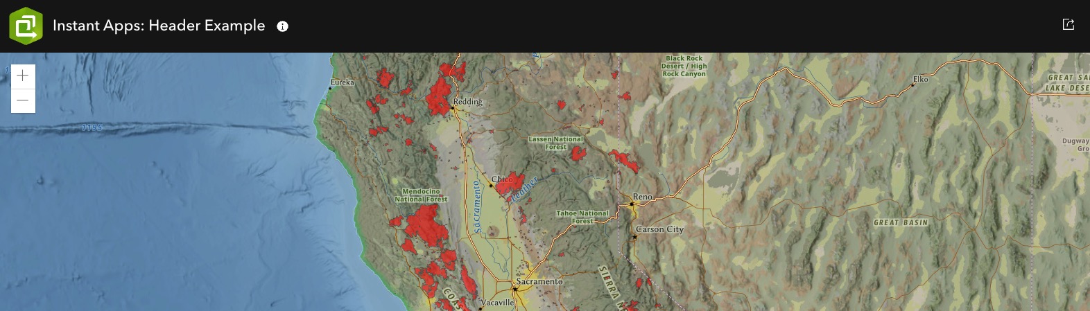

Hey! I want to change the default logo settings:
- logo size
- logo aligned on right side
However, I can't figure out the css element and settings. Btw, is there any documentation of css tags and settings for instant apps? Would be a great resource.
Thx
Chrijo
RyanLibed
Hi @chrijo_nrw
You should be able to control the width/height of the header and logo with the 'Custom CSS' setting within the Instant Apps configuration window (Theme & Layout > Theme > Custom CSS).
The properties that you use will be based on the logo scale that was set.
Example:
instant-apps-header {
  --instant-apps-header-logo-height--logo-scale--s: 80px;
  --instant-apps-header-logo-width--logo-scale--s: 80px;
  --instant-apps-header-height--logo-scale--s: 100px;
There is documentation of CSS properties for the instant-apps-components throughout the app (header, social share, etc.), but currently, not every part of the UI for each app.
Documentation on the header specifically can be found here:
https://github.com/Esri/instant-apps-components/tree/master/packages/instant-apps-components/src/com...
Hopefully this helps!
