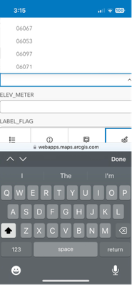

1) When clicking on a dropdown menu, the editor/map zooms in more so it is harder to navigate in the editor tab. The keyboard (I am using Apple/iPhone) also takes up half the screen so that the fields are more difficult to fill in.

Thanks for reaching out about this. I was testing this in Sidebar and was seeing some of the behavior that you are as well.
I tested editing in Sidebar on an iPhone and I think I am seeing the behavior you described. When I click into a field my phone automatically zooms/centers on the field, making it slightly difficult/tight to add. Especially when I have coded values. Is this what you are seeing?

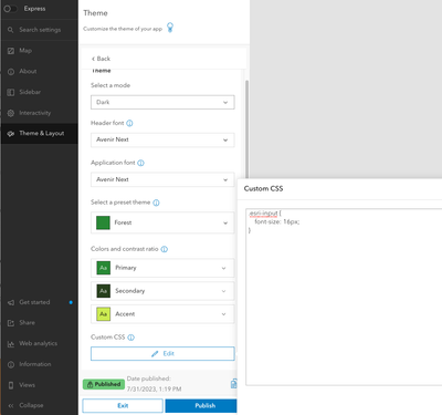

For the issue with the zooming, I was able to find a workaround for that. In the Sidebar app configuration if you add custom CSS, and add:
.esri-input {
    font-size: 16px;
The automatic zoom on the phone should go away. The auto zoom is happening because mobile devices have a text size limit that if not met when typing into a text box, the phone will zoom into. The custom css I added above is just making the text a size larger so the auto zoom doesn't occur. Let me know if you have any questions.

Hi @SarahMcDonald_Esri, thanks for looking into it! I did that custom CSS part and it seems to remove the zoom as you mentioned. unfortunately, it still seems a bit glitchy where interacting with the list and the form itself is not very easy to use. Please see the attached video I recorded. It may look a bit confusing, but shows where I am having issues scrolling up and down the list based on whether the list shows above or below the dropdown bar.

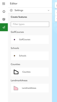

1) If I have the layer editing privileges set to add-only, can I remove the "Edit features Select button" above "Create features"? We would only need the latter.
2) It looks like if you click "Create features" and press on the map multiple times, it creates multiple points at once (once you fill the form and submit). Is this intentional behavior? I think it may cause confusion and extraneous points on the map, which may be quite difficult to scale to more users. Also, looks like that behavior is not replicated with directly editing in Map Viewer.

1. When I have data in my app that has Add only editing privileges I see that the "Select" button goes away, do you by chance have additional layers in your map that are not add only?
 2. The behavior you are seeing is the standard batch add behavior with the editing tool. The behavior is the same in Map Viewer. I will look into it to see if there is any way that can be disabled, but for now that is the default behavior.
