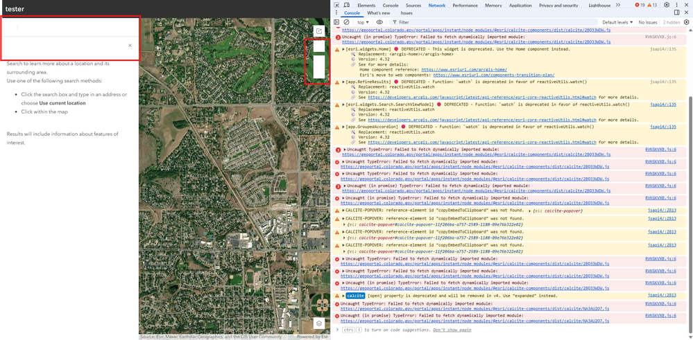

Hi there, hoping someone can help me diagnose a problem I'm having with Instant Apps (Nearby template) in ArcGIS Enterprise 11.5.
When publishing a new Nearby instant app in our 11.5 production deployment, we're finding that the app doesn't function at all (see screenshot below): there is no search bar, zoom/home tools, or "Search this area" button. It sort of seems like the app never fully loads (map doesn't display either). When we test in our dev and stage environments, everything publishes and functions fine.
Has anyone experienced this type of non-functionality before, and/or does anyone know where I can start looking to resolve this? Also, do folks know if the underlying geocoding services would impact the functionality of this particular instant app template? That is a known difference between our prod and stage/dev environments; we have our own geocoding services set up in our prod environment, but stage and dev just use the default ArcGIS World Geocoding Service. All log locations (portal & server admin, server manager) show nothing related to this.
Last thing: when I use the developer tools in Chrome I am seeing some failure messages such as...
"Failed to load resource: the server responded with a status of 404 ()"
"RVKGKVXB.js:6 Uncaught TypeError: Failed to fetch dynamically imported module:"
"RVKGKVXB.js:6 Uncaught (in promise) TypeError: Failed to fetch dynamically imported module:"
I am terrible at interpreting these kinds of Chrome developer errors, so any insight here is appreciated as well.
Thank you for any help you can provide!
published Nearby app in Enterprise 11.5published Nearby app in Enterprise 11.5

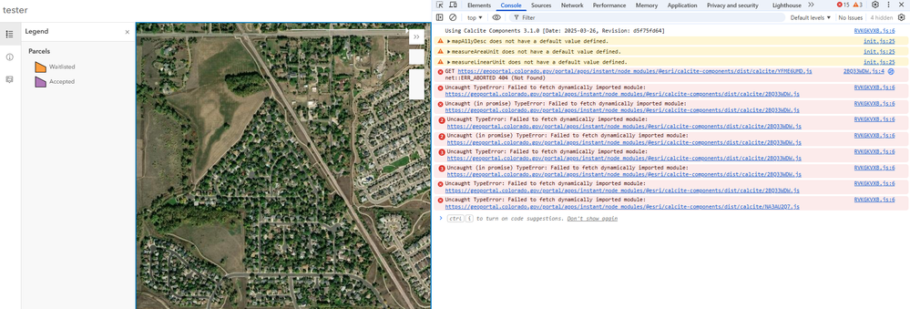

Can you share a screen capture showing the full console messages?
GrantSmith122
Sure thing, is this what you are looking for? The red boxes show the missing Home and Zoom Controls buttons + Nearby widget/slider

Ok sorry one more test. If you create a basic app and disable search but enable other tools like the legend or layer list does the app load correctly?
GrantSmith122
Yep! Everything functions correctly in a Basic app when search is disabled (or enabled). If I do the URL switch trick like you mentioned above, the Home and Zoom Controls stop working immediately.
