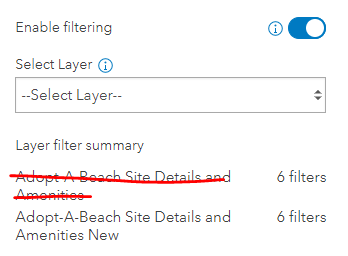

I have created a Nearby Instant App, but had to replace a layer on the original map. I cannot seem to delete the filter I had created from the previous layer; is this possible @BethRomero ? I am only able to access the filter for layers currently on the map. Here is the live app - you can see that both filters are available and I only need the New one.

@ILoveACleanSanDiego Deleting filters when the layer is no longer available is now an option with the latest update of ArcGIS Online.

Yep looks like we need to add an option to delete filters if the layer isn't available. We will look at getting a fix for this issue in a future release. In the meantime you could edit the app's json using ArcGIS Online Assistant to remove the unused filters. I would make a copy of the app before attempting the edits. And feel free to reach out if you have questions.

Oh fantastic, thank you!!
