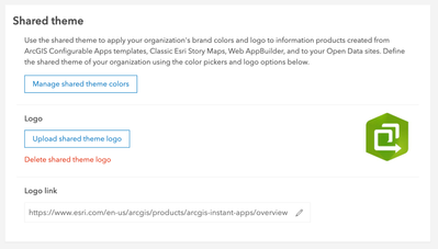

I uploaded the logo in Organization settings > General > Shared Theme:

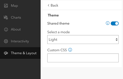

And enabled 'Shared Theme' in the Instant Apps configuration for Chart Viewer:
