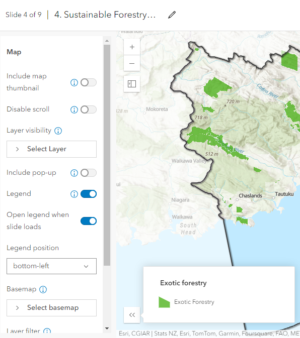

I have configured the slides to include a legend and for the legend to open when the slide loads:

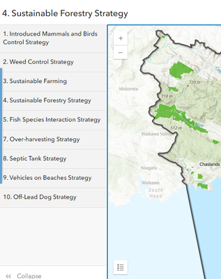

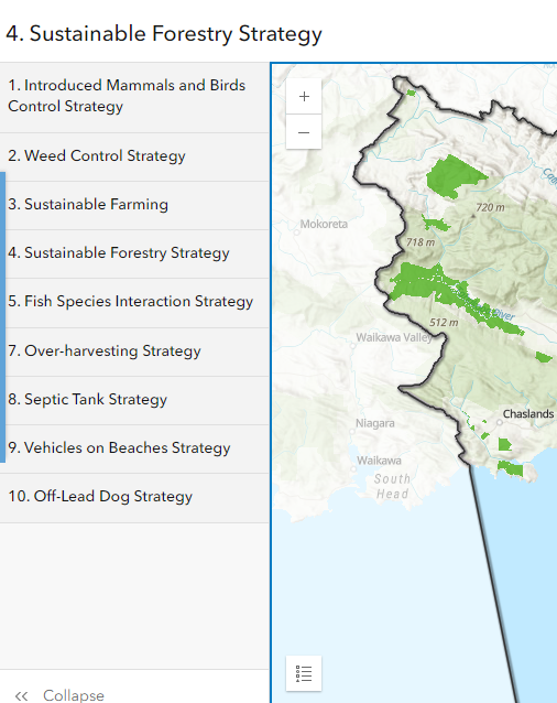

However, when I view the app overview page, or use the live app, the legend is not exploded. i.e I have to click on the legend button in each slide to view the legend contents:
How do I configure the app always to display the open / exploded legend?

Joyce_Val
Hi,
I think you have to turn off the Express Mode in the Instant App. Then choose 'About'>'Location Data'>turn on the slider on 'Open when the app loads'. (or something similar, because my portal is another language)

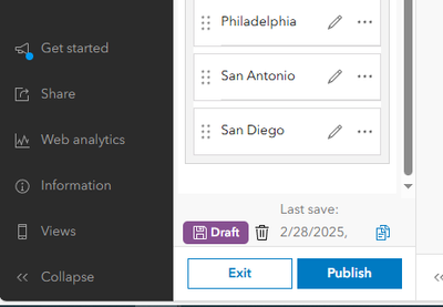

IanWittenmyer
Hi Perry,
This is a setting that is controlled on each slide.  Can you confirm that "Open legend when slide loads" is toggled on and that the changes have been published?
If your app has unpublished changes, it will display a 'draft' badge.
