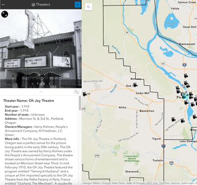

Hello,
I am working on an Attachment Viewer instant app to showcase art pieces in our municipality.
I'm trying to make the attribute information a bit more plain text and less tabular. I would like to add a description for these as well, without having to add a really huge description text field in the attribute table for the data.
Looks like the Town of Gilbert in Arizona was able to accomplish this in their Future Development Attachment Viewer seen here:
https://tog.maps.arcgis.com/apps/instant/attachmentviewer/index.html?appid=b7490ff2d19b4dbabe8f79a12...
Compare that to a screenshot of mine which is stuck just showing the attribute table in tabular layout. attachmentviewer1.pngattachmentviewer1.png
Any idea how they accomplished this? They even have different font sizes in their attachment information as well.
How I created mine was a feature layer of art locations with attachments set up in ArcGIS Pro, published to ArcGIS Online and configured in MapViewer as a webmap. Maybe I need to have this set up a different way?

Hi @twilliamson_topv
Thanks for reaching out about Attachment Viewer. The pop-up panel in the app where you are seeing the attribute information is controlled by the pop-up. You can update this to look more like the app you referenced by updating the pop-up configuration for your attachment layer in Map Viewer. https://doc.arcgis.com/en/arcgis-online/create-maps/configure-pop-ups-mv.htm
Let me know if this helps or if you have any additional questions.
Thanks!
Sarah

twilliamson_topv
Incredible!
You rock, thank you!
