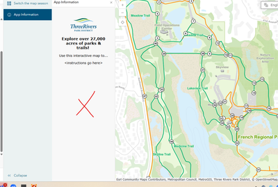

@KellyHutchins we would like to change the color of this element to white, are you able to send the CSS in order to do so?
Thanks!

Looks like sidebar correct? Yes but the image above looks white to me (could be my monitor). I'm trying to determine if its the panel that is a different color or if its background to the content in the panel? Here's a sample app where i've modified the colors for both of those sections using obnoxious colors to make it easy to determine which you want to modify:
https://jsapi.maps.arcgis.com/apps/instant/sidebar/index.html?appid=95f26b9abb834827a168f628c08d9695
Once you determine the color to change you can use the value #fff to set the color to white.
#details{
background-color:magenta;
#details-panel{
--calcite-panel-background-color:yellow;
