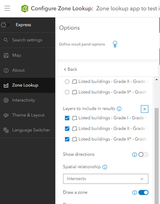

I have exactly this issue too.  I have the tool configured to use the intersects option:

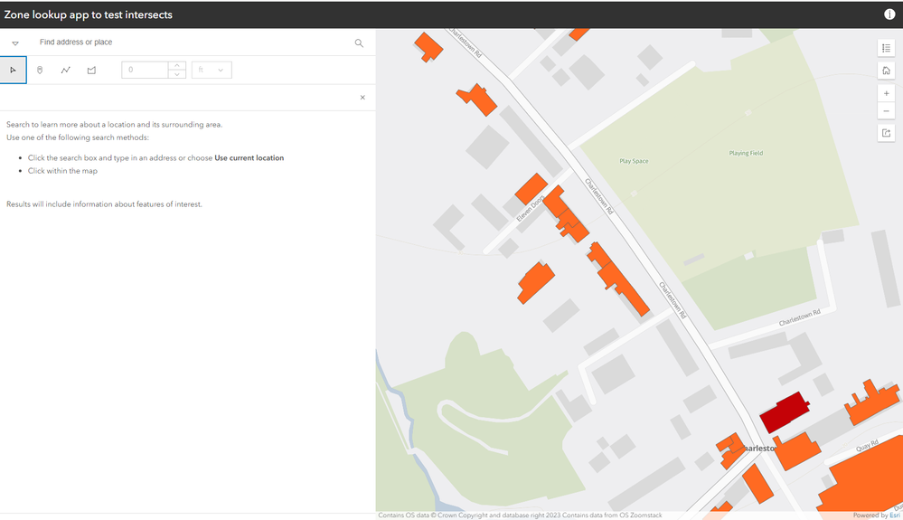

This is the map on opening - note the large orange building in the centre of the map:

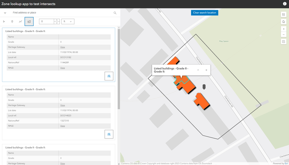

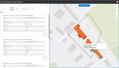

If I draw a polygon that cuts through that building, with the spatial relationship set to intersects, it should be returned, but it isn't:
I've logged a call with ESRI UK about it, but if you can help @KellyHutchins it would be appreciated.
