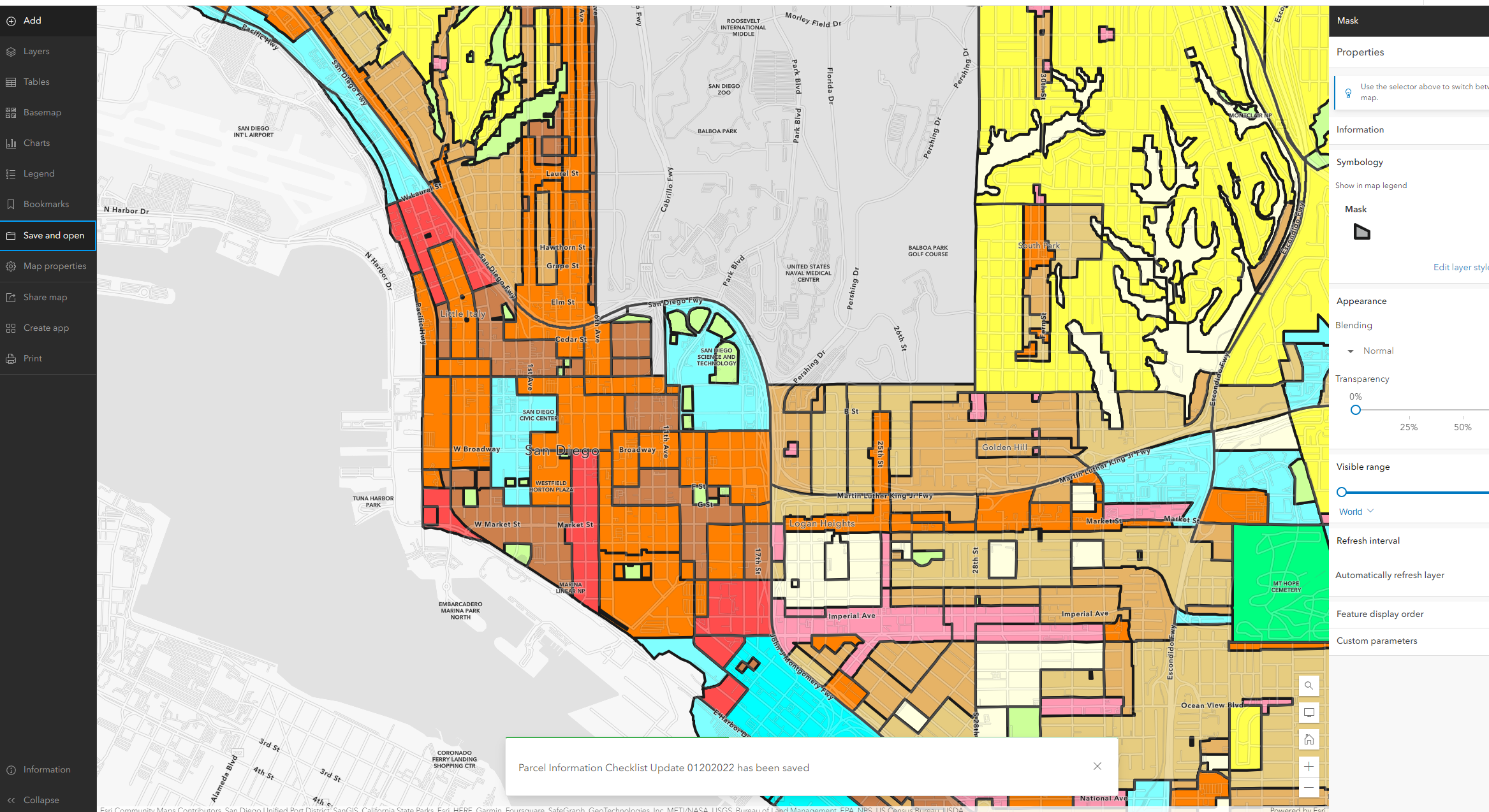

Previously in Map viewer, to set the desired default map location and zoom level, you just set the map as desired and hit save.  I use a bookmark to keep it consistent.

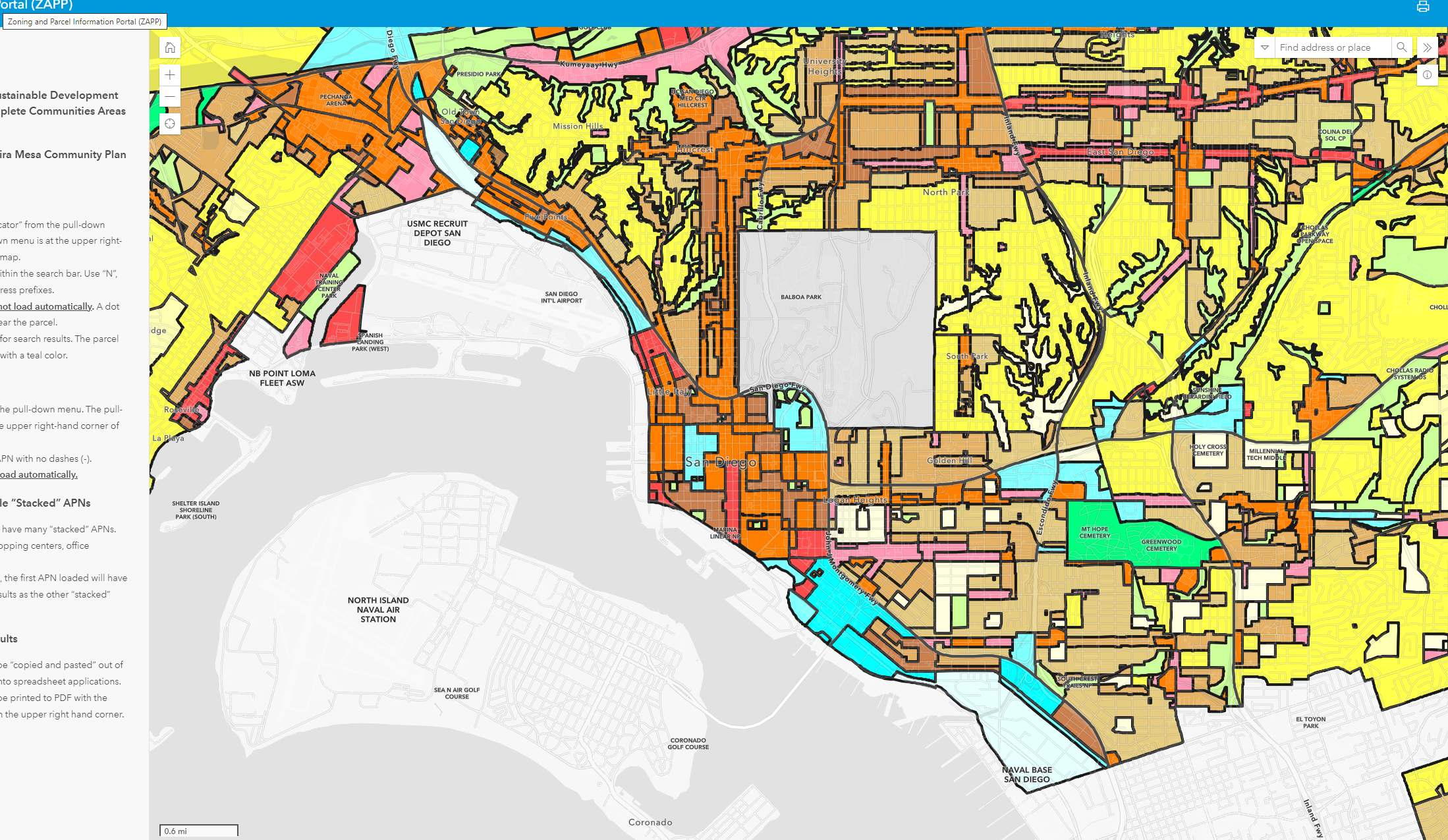

When the map was loaded in an Instant app would load to that centered to that location and zoom level.  This appears to no longer be the case.

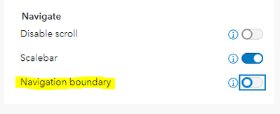

It could be an aspect ratio I can't tell from the screenshots if the map area is the same width/height in both images. Also did you configure a navigation boundary for Sidebar - that could be overwriting the default extent?

Thank you for the quick reply.  I only made a minor update to the maps pop-up, did change the map location and zoom level.  The Sidebar app map location and zoom level look very different than just a few days ago.
I checked and Navigation boundary is off

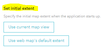

Is there a way in Instant Apps to set the initial extent?  Like we could in webapp classic?

Thank you for looking into it further.  I updated the map last week as well, the change did not happen until I updated the map today.  I don't know if it's something on the map viewer side, or with instant apps.  Something is different.
It took a few attempts to resize the map to get the instant app to default to my desired zoom.  So at least to the end users they should not notice much of a change.
I also added the Set Initial Extent to the Instant App ideas page.
