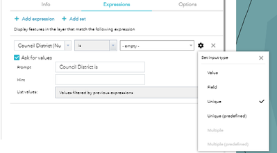

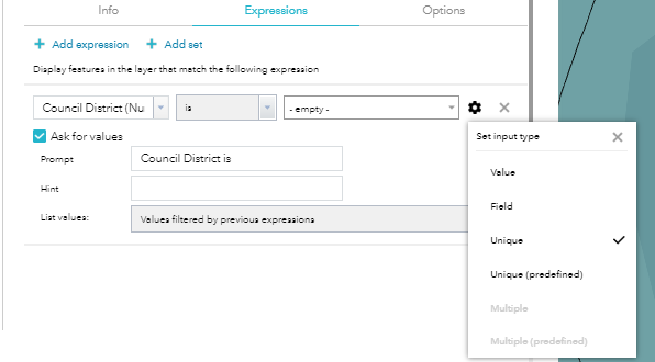

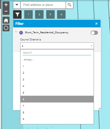

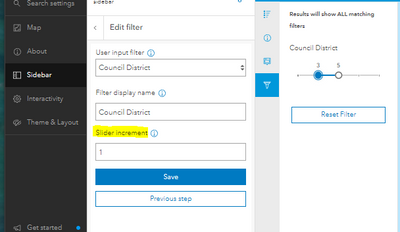

It seems in Instant app, there is only a Slider Increment option. For filtering by Council District, it would be nice to have a single drop-down selection option.  Is there an option to configure the filter for single unique values?
I am looking to be able to Filter like in webapp (classic)

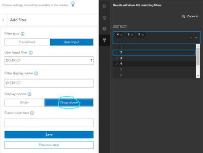

Hi @KellyHutchins,
Noticed a Drop-down option has been added for numeric fields.  Thank you
KellyHutchins
Esri Notable Contributor
Currently for numeric fields we show the slider. We'll look at the feasibility of adding optional dropdown support for numeric values in a future release.

Hi @KellyHutchins,
