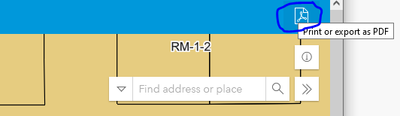

Ideally I would like to use the "Print or export as PDF" widget with a printer icon, located on the same panel (top right of the pop-up) in the Sidebar instant app
Sidebar instant app (PDF logo, top-right of header only)
Exhibit instant app (printer icon, adjustable around map)

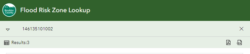

Zone Look-Up instant App (PDF logo, top-right of pop-up)
Is there a way to change the pdf icon used in the Sidebar instant app to match the printer icon used in the Exhibit instant app both for the "Print or export PDF" widget?
In the Sidebar instant app, is there a way to adjust the location of "Print or export PDF" widget?  It seems it can only be placed on the top-right of the header bar.

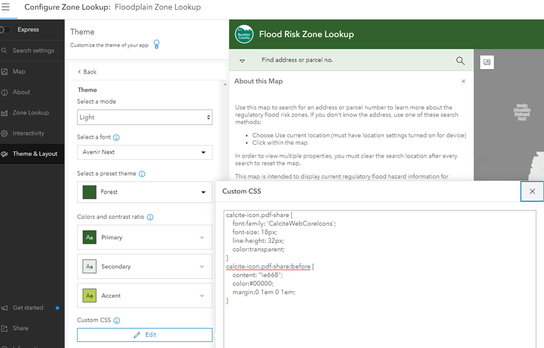

Thanks for the feedback. We chose the export to pdf icon because the print icon is used in a few apps for the Esri print service widget. We are going to update the exhibit app icon to match that used by Sidebar and Nearby.
It isn't currently possible to adjust the location of the export to pdf tool but with some custom CSS  you can change the icon to a print icon. In the app configuration there is a theme section and at the bottom of that section there is an option to add custom css. Here's the css you can use to show a print icon. Note that depending on the theme of your app you might have to change the color value to something other than the value i set in the example which is white (#FFF).
calcite-icon.pdf-share {
    font-family: 'CalciteWebCoreIcons';
    font-size: 18px;
    line-height: 32px;
    color:transparent;
calcite-icon.pdf-share:before {
    content: "\e668";
    color:#fff;
    margin:0 1em 0 1em;

Hi Kelly,
I tried copying your custom CSS text above into the theme section as you described.
My print icon doesn't change. It still looks the PDF symbol. I cleared my cache and refreshed my browser too.
I'm not sure what I'm missing. Do you know why it's not working for me?

Hi Kelly,
  Thank you for the speedy response.  The custom CSS seems to be working great.

Try this for Zone Lookup
calcite-icon.pdf-icon {
    line-height: 32px;
    color:transparent;
display:inline-flex;
font-size:20px;
line-height:25px;
calcite-icon.pdf-icon:before {
    content: "\e668";
    color:#333;
MollyWatson1
Thank you that worked!
