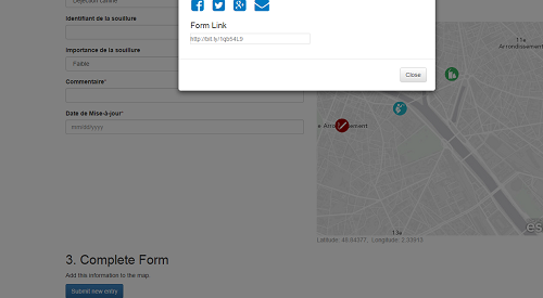

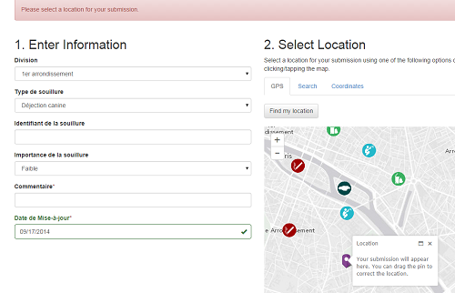

I have a problem with the new geoform template.
When I submit new entry, the new point on the map disappears
I used a feature service . the projection is ok.  The feature service i used there works well in the webmap agol.
But at the end when i submit new entry, the new entity and data are not added on the map nor in sde..
I am blocked
would you have a track ?
1/ submission of new entry
2/the new point disappears when I submit new entry.
thanks

Hello Bertrand,
Your issue reminds me a similar one I faced.
If I am right, it was due to a field with null value not authorized:
the data input was not accepted and as a result, your object is not created.
Could you check this hypothesis?

Hi Charles-Henry,
this is the good way. I have just tried and everything works perfectly. It was due to a field with null value not authorized.
You have reason. I can use now the geoform template.
Thank you very much for this effective answer !
