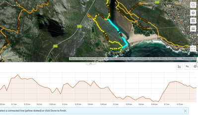

  1. Elevation profile display: Ah, yes that is so, thanks for pointing that out (might be worth putting a tooltip explaining that adding the link to the pop-up overrides it displaying in the actual map?). However, there is still something slightly buggy, as it only displays in the published version and not in the configurator:
2. Multiple segments in profile: It would cool to see multiple segments in one profile (like in the tool function in the Experience Builder). In EB the next optional segments that you can select are highlighted in yellow which joins multiple sections (which is great!).
2.1 The direction-change switch is also helpful and would be great if it could be included in the Instant Web App version. An even better development would be if you could use the "New Profile" function that snaps to a line-segment layer (though I appreciate that that would be quite advanced).
2.2 It would also be helpful to have a little start and end icon on the highlighted segment (Maybe a white dot on one end and a checkered flag on the other), to help indicated the orientation of the highlighted segment.
