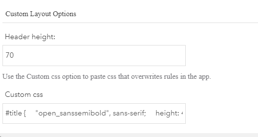

It shows up as:
I'm customizing the Story Map Basic template and using inspect in chrome to make changes + copy the code snippet above and paste into the custom css box when configuring my web map. I'm trying to get it to change to Merriweather (Google Fonts) for the title and have tried pasting the following above the #title but that didn't seem to work.

Thanks, that worked. The only issue is when I take my code and paste in the custom css box, the change goes away back to the old font.
#title {
font-family: font-family: merriweather !important;
height: 45px;
padding-left: 4px;
padding-top: 0px;
font-size: 40px;
font-weight: 400;
text-align: left;
white-space: nowrap;
text-overflow: ellipsis;
overflow: visible;
Where it says "open_sanssemibold..." was replaced with the font-family: merriweather !important;  but doesn't reflect in map anymore.
