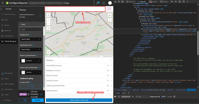

Is it possible to Change background color for the button and Hide the Header in Reporter Instant App using Custom CSS?
I tried this script it doesn't seem to work for button background color. I haven't got too far to try anything with the Header yet.
Custom CSS:
calcite-button{
    background-color: red;

Yes it was fixed. What are you trying to change? It can be tricky and require CSS knowledge to know how to modify something. Here's an example where I added this css to make the "Report an Incident" button to turn it orange.
calcite-button{
--calcite-color-brand:orange;

You can hide the header by turning off the header in the app configuration. To find the header setting use the search box to search for "Header" and disable that option.  I'll check with the Reporter team about the button color.
FonPunnakanta
Thank you very much for your reply! Header is now gone! Looking forward to hear more on the button color!
