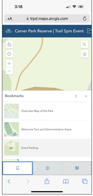

We recently noticed an issue with specifically the Sidebar Instant App. When viewing the application's configured bookmarks on a mobile device, the map centers behind the bookmark window. Because if this behavior, users are not able to see the area they just selected, this leads to user confusion/user error.
Screenshot of the issue:
In the screenshot above, the bookmark has been configured in the web map to show the entire parking area. When viewing it on a mobile device, the parking area is hidden behind the bookmark window.
Please resolve this issue as this impacts our current and future planned projects in this application.

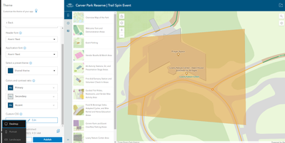

Here's an example:
In desktop the bookmark will look like this- including the entire AOI (area of interest):
In mobile view it appears like this- the map extent/AOI is cropped/zoomed in.

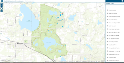

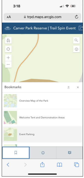

The way the Web App Builder handles bookmarks is a great example for what we're looking for in the Sidebar Instant App. The Bookmark/AOI is not cropped, and the map is centered at the top of the screen (without custom CSS).
Here's an example of what that looks like below:
Desktop bookmark extent:
Mobile view for bookmark extent:
Can this be resolved/have an equivalency for bookmark behavior on mobile devices?
