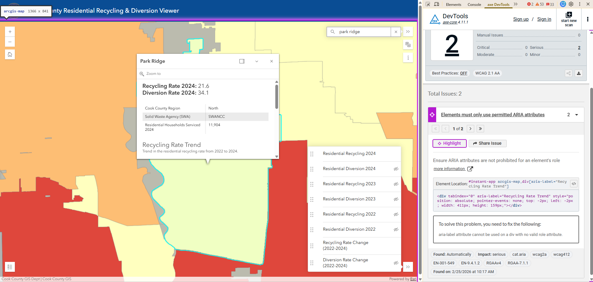

Issue:
This is a unique one in that there is an aria label inside of the div but because the div does not have a role assigned to it screen readers and other assist tools will ignore it all together. Since this div is created from the map I do think this falls under ERSI purview to fix. Has anyone else seen this issue and been able to fix it?

I'm trying to repro this with Axe dev tools but so far no luck. I'm assuming it comes from the popup chart header but if I inspect that element I don't see an aria-label set.
sigccil
hi @KellyHutchins,
I just retested this on three separate browsers; Chrome, Edge, & FireFox, and I too am unable to reproduce the error. After inspecting the code it looks like role has been updated in the div tag, see below. Is there a way for you verify if an internal team fixed this issue?
<div tabindex="0" role="figure" aria-label="Recycling Rate Trend" style="position: absolute; pointer-events: none; top: -2px; left: -2px; width: 348px; height: 159px;"></div>

There was a release of the ArcGIS Maps SDK for JavaScript in February that may have resolved this issue.
https://developers.arcgis.com/javascript/latest/
Do you know when you found the problem originally? If it was before Feb then perhaps it was addressed in the latest update.
sigccil
3 Weeks ago on 2/25/2026.
To be clear, some fix in the ArcGIS Maps SDK for JavaScript release may have fixed one of the components in the instant app?
