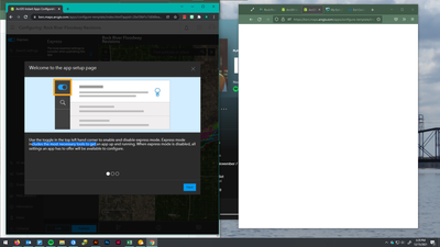

I'm not quite sure why the configuration page doesn't load in Firefox, but it's frustrating to have to open a different browser each time I make instant apps. I've tested this on multiple computers and multiple apps, and always get a blank page in Firefox.

If you right-click the page and select the 'Inspect' option, do you see any errors in the developer tools within the 'Console' tab? If so, what are they?
Also, I'd be curious to see if temporarily disabling the adblocker in Firefox helps with anything.
Just ran a quick test in Firefox and the Instant Apps configuration panel is loading successfully on my end. My version of Firefox is at 95.0 (64-bit) on a Mac machine.
