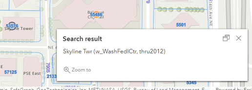

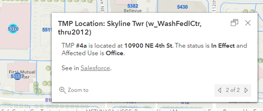

In the Interactive Legend app, one can configure searching on layers within the webmap. After a successful search, the feature is highlighted, zoomed to and a popup displays. The main issue is that it's a generic popup, rather than the popup configured for the webmap. For example, I have configured popups to display like this for my TMP layer:
The popup shown after a search for a TMP feature, is like this:
I'd like the search to show a popup like in the first image. As it stands, users don't see the information they need. In order to see it, they need to do several extra steps, like clicking on the feature and paging through popups. All of which is completely redundant.
