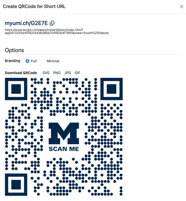

Here is the QR code from the URL shortener:
Unfortunately the QR code encodes a modified version of the shortened URL:
https://myumi.ch/G2E7E?source=qrcode
When our URL shortener is contacted at this URL, it returns:
https://www.arcgis.com/apps/instant/basic/index.html?source=qrcode&appid=3205e45f82c64dbd8bb704f82b4...
So when you scan the QR code, the URL you get doesn't work as expected, as ArcGIS fails to interpret the plus sign as a space.
