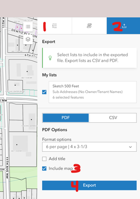

Hi! I'm not Sarah, but in the Public Notification Instant App, after you run the mailing list (1) you open the export tab (2) and then click the map option (3) and then export.
