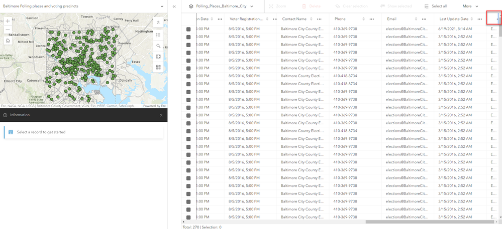

Hi @PaulDoherty2 ,
You mentioned in your comment that you were not able to resize last column, could you please try to use the right most bar of the last column to resize? When you hover over the top right corner of the last column, a blue bar and the move handle will show appear, try to use that blue bar, you should be able to resize it.
